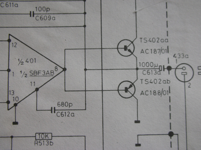

There is no direct equivalent in modern ic's but do you know secure the IC is defective ?? and not the surrounding capacitors or output transistor pair.
The solution of implant a newer output-set good be easyer
Lookalike output stages at: 22GF614, Aristona SG2603

![[image]](images/uploaded/2014020116550352ed18d7cb663.jpg)
![[image]](images/uploaded/2014020116552352ed18eb6e5aa.jpg)
SBF3AB Philips 482220980261, waarschijnlijk ook toepasbaar
Plaatjesverantwoording: Circuitsonline

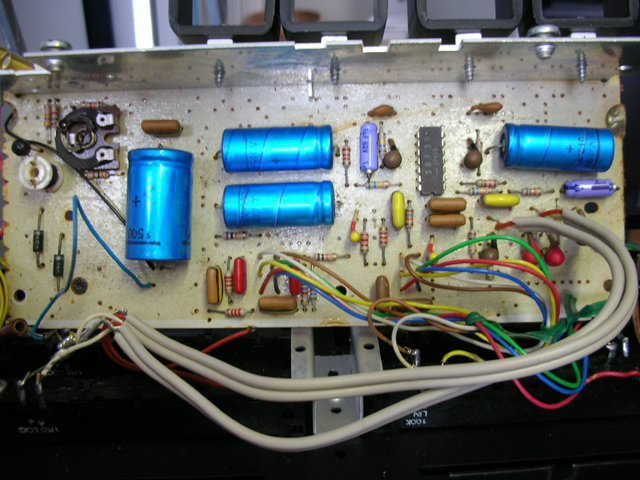

Replacing IC SBF3A
door vanderlevin, 01-02-2014, 16:08 (4445 dagen geleden) @ franshack
Many thanks for all peplies! The IC is missing! The owner before tried to repair it and never replaced it and left the board empty!
/Johan
