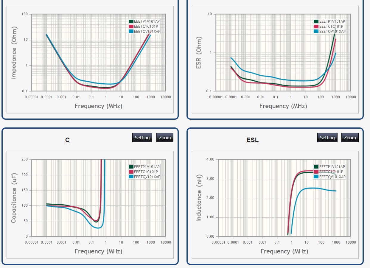

Panasonic TP-SERIE
3 type van 100uF 35V Panasonic, TC TP TQ
