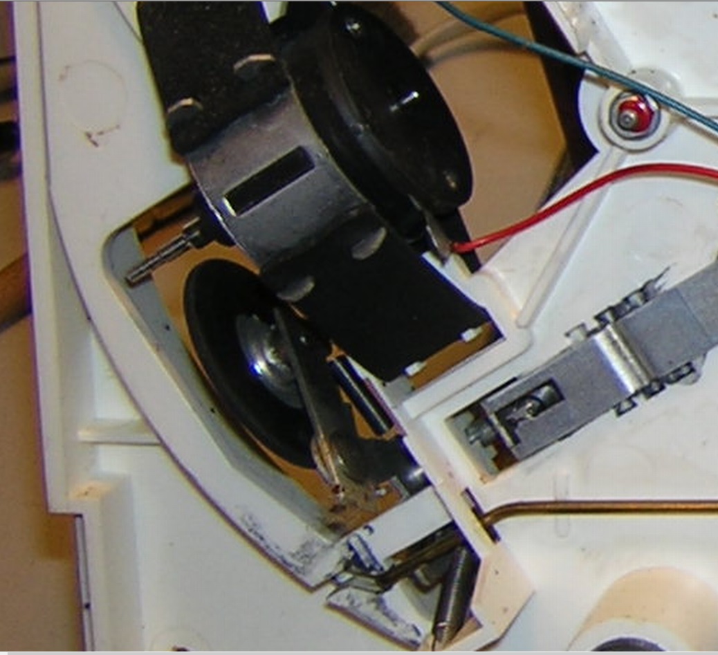

With a cotton cloth and break cleaner you can clean of the edge to a nice dull surface.
If completely harden you can try put it for couple of minutes in boiling water.
Picture of that idler, maybe some one has a good spare.
