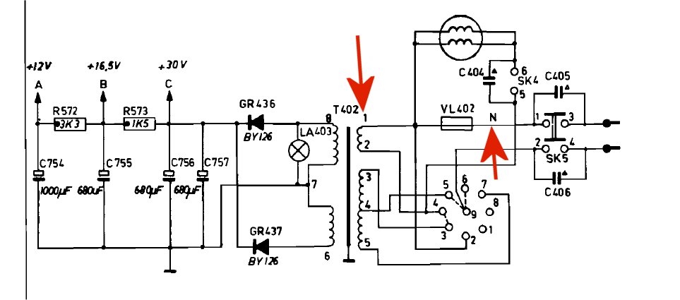

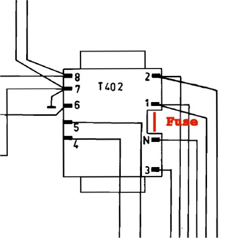

Fuse should be between terminal N and 1.
That is middle 2 terminals at side Primair.
The gab in the top pertinax terminal plate left and right from it.

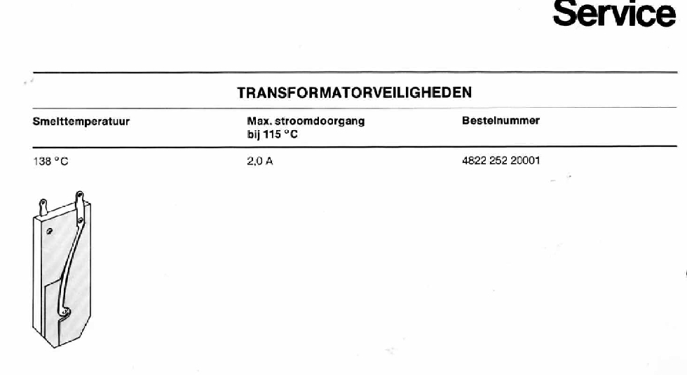

Manual VL402 - Partnr: 4822 252 20001
Indead a therminal fuse at 138C and Max I = 2,0A at 115C

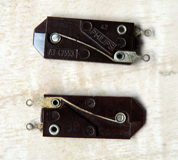

Hallo maurice,
ik heb nog wel zo'n nieuwe zekering voor die man hier liggen.
groet, ruud PA0ROJ[image]
