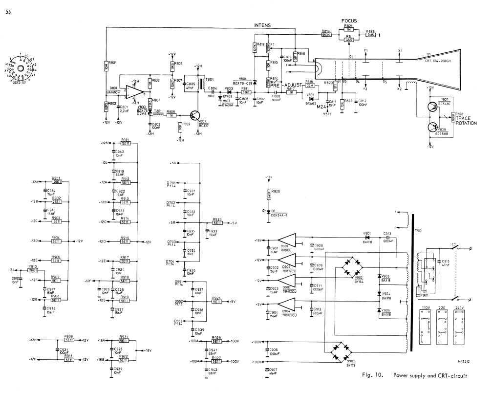

I need help to repair the power supply of a oscilloscope PM3207.
The oscilloscope came to me with a lot of problems with the power supply (the old owner tried to repair it without success).
I now have all the correct voltages except HT. In the HT circuit I found the diode V800 and transistor V801 burned. I Replaced the CI D801 and diodes V802 and V803 with new ones and checked all the other components (one by one) and they are all OK.
Now whenever I turn on the power, the V801 transistor burns...
What is wrong, for that to happen?
Is the CRT broken?
![[image]](images/uploaded/202011020009365f9f4e40849bc.jpg)
Many thanks.
Regards.
Carlos

No, it's probably not the CRT.
T801 and V801 form a simple oscillator, the output of which is used to generate a negative high voltage.
It is a little bit confusing that the third winding of T801 is drawn separated from the other two.
How fast does your transistor burn?
Also check the rectifier circuit (C804 806 807 and V802 803). A short here will overload the oscillator/generator circuit. V801 might go but not in a second.
T801 should be a small transformer with 6 terminals.
It might have a short circuit in one of the windings (hard to check, could be done with a square wave generator and a scope, but your scope is broken...). shorted windings are probable with HV transformers, but it depends on how well built it is and how much power it must deliver. I don't have experience with this one. Does it look ok?
An interruption or short in C805 might cause trouble. You might replace it but you might burn another transistor if it's not the cause.
You say V800 was also burnt. This is odd because I think it would never get too much power on this position in the circuit. Because of V800, also check R804.
Maybe C802 is interrupted. Check its capacitance. It is needed to make V801 oscillate, without it, V801 would probably stay in an on-state and maybe burn.
You would also like to check the regulator circuit around D801. With V801 removed, solder a 82k5 (like R802) (82k is also ok, or even 47k) resistor temporarily between -12V and pin 3 of D801. The output on pin 5 should be the same voltage as pin 3 now when you switch the scope on. (with V801 removed, there is no HV, no smoke and no stress on T801). If it is not, D801 is defective or one of its resistors.. But I don't see if it could really fry your V801. It could give +10 or12V output if defective and make V801 work too hard, causing a too high HV (which might then destroy T801).
By the way, if C802 is interrupted, D801 would give a high output too, because there is no HV.
Do not forget to remove the temporary resistor after checking D801.
So the first two things are to check the two capacitors and the rectifier circuit.
Then the most likely cause is the transformer, which is a bit hard to verify, and probably hard to find a replacement for.
The regulation circuit might have a problem, check that too, just to be sure.
Onno

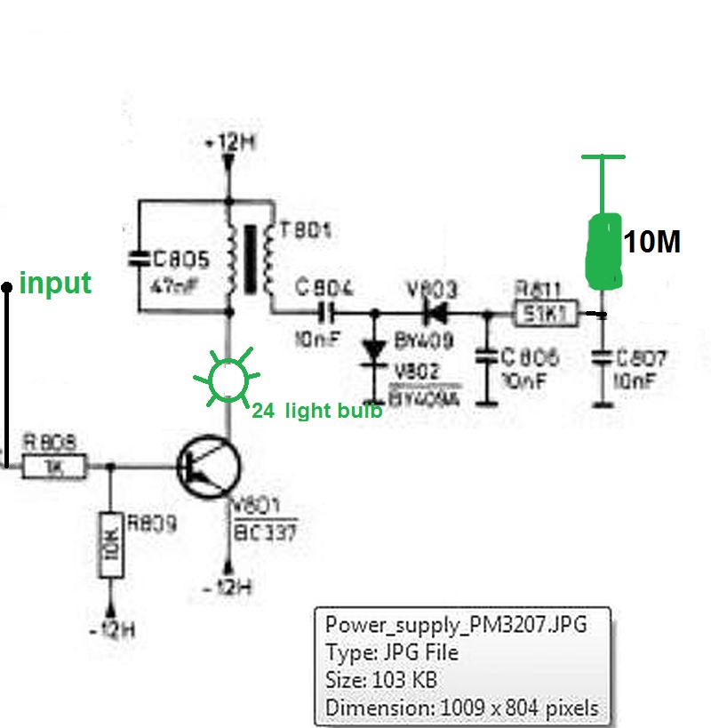

I also been looking at it.
Put a 24V lichtbulb between Bc337 and T801, so the current is limited at 0,8A
the max current BC337.
Take R811 out at 1 side.
Than LM741 flip arround V1 to drive BC337.
Think cut that 10M resistor and put an external oscilator at V2
See what hapens

Hi.
Now i have an oscillator an a oscilloscope.
I pull up the resistor 10M and put the oscillator in pin 3 and put a 24V light bulb between Bc337 and T801.
I got these photos.
I wanted your opinion.

Interesting. The transistor and transformer do oscillate when the base is not too positive.
What is the frequency you used? The oscillator should operate at 30 kHz
The signal you use seems to switch the oscillator on and off. But it is oscillating when it should be off, and is drawing lots of current when it should oscillate.
Please disconnect T801 from R808. feed a 30kHz sine of 1Veff into R808 and look at the signals on T801 (not the HV winding).
Touch the connection of T801 to C804 with a small, well-insulated screwdriver, 750V AC should be here, you should see a small spark if you have the screwdriver 1 mm from the connection.
What is the frequency you used? The oscillator should operate at 30 kHzThe signal you use seems to switch the oscillator on and off. But it is oscillating when it should be off, and is drawing lots of current when it should oscillate.
Hi.
I put new the V802, V803, C804, C806 and C807 and I did it (30 kHz, 1Veff). I don't have the 750V AC.
Then I removed the light bulb between Bc337 and T801, and the and the transistor burns.
For all this, I think the defect is in the T801 transformer.

I am also worry about that oscillating BC337.
Could indeed something with that transformer.
Pull secondary R811 and series with a 10M Ohm resistor to ground.
Now you have only made a rough power supply.
Again at R808 that 30kHz as Onno mentioned.
See what happens.
Remember that with BC337 you short out -12V to +12V
Only to the fact of delay of current in the coil T801 it will act as a resistor.
But if that delay is a bit too long it will act as a DC and there BC337 will blow.
As if any other big transistor at this point.
So don't lower the frequency, keep light bulb in series too.
That is the main problem with PWM supply's.
If there is even a minor problem like chain reaction all components give up.
Than what you can do is measure that transformer with frequency.
Think just solder out.
Put primair winding frequency and parallel your scope.
Find a voltage peak at 1 high frequency.
Then look up internet how to measure that coil impedance through scope and generator.

Two questions:
1- what were the waveforms on the base, collector of V801 and on the primary side of the transformer (where it was connected to the bulb)
2- did you have spare BY409's to replace V802, 803? (I wouldn't have the originals, but use BY176 from an old TV)
they are quite special rectifiers, rated at 11,5kV. In 1980-1990 color TV's there would have been one (or an equivalent) for the focusing voltage to the CRT.
They are quite unlikely to fail in this place, where they get a peak inverse voltage of 1500V (3000 if you take a wide margin)
I wouldn't replace them by an ordinary 1N4007, maybe a chain of four each if I was out of options.
By the way, it you test a BY409, they have a forward voltage of 36V so you might think they are interrupted if you test them using the diode test function of your DVM.

Hi Onno,
i know i can't test these diodes with the DVM, because that i put news. Not the BY409A but the equivalent BY713.
I did the test that Maurice said but I didn't get any HT signal.

After that, i removed the transformer and made the circuit on a test board and
did not get any HT signal.
![[image]](images/uploaded/202011071652535fa6d0e54690f.jpg)
When I put the 30kHz signal the light bulb turns on.

After all this, the transformer is the remaining suspect.
But the oscillograms are a bit confusing: I'd expect the collector current to clip. But you have a nice sine.
What is the scale (V/div?)
Hopefully someone can help you to a new transformer.

I think that is the transformer
In the first picture i have 1 Vpp, in the second i have 10 mvpp, on the third i have i little less.

Good job so far in debugging the problem.
Rewinding the transformer is duable.
Bit of a job but can be done.
If ferrit is glued heat it first up than hopefully the glue weakens.
You can buy those cores (link) and with some re engineering, counting it can be done.
See it as a challenge, i think.
They are not that expensive to buy on the internet.
But should be fun you get this one going again.
Or maybe there are other way's to get that 1500V.
