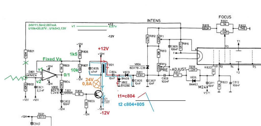

I also been looking at it.
Put a 24V lichtbulb between Bc337 and T801, so the current is limited at 0,8A
the max current BC337.
Take R811 out at 1 side.
Than LM741 flip arround V1 to drive BC337.
Think cut that 10M resistor and put an external oscilator at V2
See what hapens
