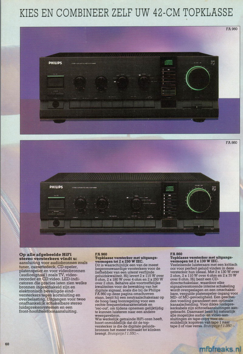

door Maurice ⌂ @, Dordrecht, 04-03-2023, 16:44 (1014 dagen geleden) @ Gerard in Zeist
Mijn Philips FA960 gaat tot 2 Ohm
Specificatios Philips FA-960
Power Output (acc.to FTC):
100 W Continuous sine wave at 8 O load (20-20,000 Hz, THD less than 0,03%)
125 W Continuous sine wave at 4 O load (20-20,000 Hz, THD less than 0,05%)
Power Output (acc.to IEC)
115 W Continuous sine wave at 8 O load (63-12,500 Hz, THD less than 0,03%)
Power Output at 1 kHz, THD less than 0,7% (acc.to DIN):
At 8 O load : 115 W
At 4 O load : 180 W
At 2 O load : 250 W
IHF Music Power:
At 8 O load : 120 W
At 4 O load : 225 W
At 2 O load : 280 W
